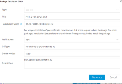

We use HPDM5.0, and i am looking for a bios update (with HP update center) for the HP T530 thin client.
M41_0107_Linux_x64 is only available for HP ThinPro 6-64/HP ThinPro 7 but not for Thinpro 7.2
The downloaded HP ThinPro 6-64/HP ThinPro 7 version is not visible for Thinpro 7.2 clients.
Any thoughts how to obtain it for Thinpro 7.2 ?

BIOS update script used in HPDM is common for HP ThinPro7, 7.1 and 7.2. The only part you need to take care is when you import the script you need to make sure to select ThinPro7.2 as the OS. This will ensure that the Template gets copied to the right OS Tab. Then you can send it to the unit.
Since you have mentioned that the units are at different location. Its better to setup a Child repository at that location to ensure the file is copied without delay.

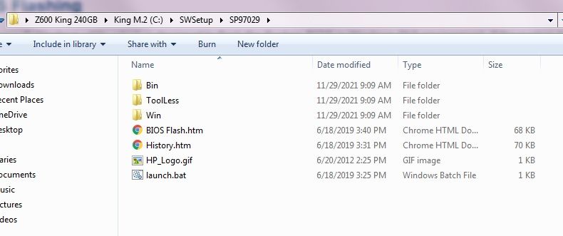

Yes, HP has not made it easy to find but it is there:
Search google for Thinpro 7.2 T530 hp drivers and you'll get a HP link at the top.  Go to that link... you need to change the OS selection from the dropdown for Windows. For me it defaulted to OS as Linux.  Change to Windows and move to the right and use that dropdown to go to the very bottom:
I downloaded that by highlighting and choosing save as to my desktop.  Ran that SoftPaq as admin.... you can unpack it on pretty much any Windows OS and any computer.... it will not try to update the BIOS on the computer you unpack it on.  It is stored on the root level of C in a folder SWSetup.  Inside that looks like this:
The instructions from that are attached as a PDF below, at the bottom.  For those of us running workstations we have found that running a BIOS updater program built for Windows XP or W7 under W10 adds a layer of risk.  I therefore only update BIOS from within BIOS... never from within the OS.  HP has built this capability into BIOS, and BIOS is a primative OS if you think about it.  I have no experience with updating Thin Clients but the instructions attached should help you.

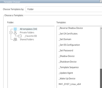

But i want to update the HPDM install so i can send an automatic script to the T530 , this template / script copies the update to the thin client and performs the update fully automatically
These are the templates for Thinpro 7.0 (with the bios update available) on our HPDM server
This is the HP update center to open from HPDM , and the Bios update T530 for Thinpro 7.2 is missing ?

Thanks !
Its not very clear that you can change the OS, but you can
