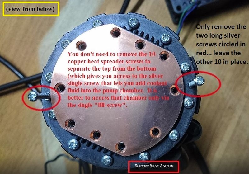

Attached are 4 images from a prior post related to the Z420 liquid cooler, which some of us have adapted to use in the Z620 workstations also.  This info mainly is from another related post, with some clarifications.  I have no idea if the Z820 liquid cooler can have its top easily removed the same way to allow access to a filler port screw from above... I would think so.  My guess is that it is best to stay out of the inner bottom pump chamber given the easy access through the silver filler screw from above.  I'd fill very carefully with a syringe through that access port.  See also the attached PDF of the original post, below:
Stock Z420 liquid cooler from belowStock Z420 liquid cooler from belowOnly remove 2 screws...Only remove 2 screws...Top access now to the filler screwTop access now to the filler screwBottom of the filler screw...Bottom of the filler screw...
