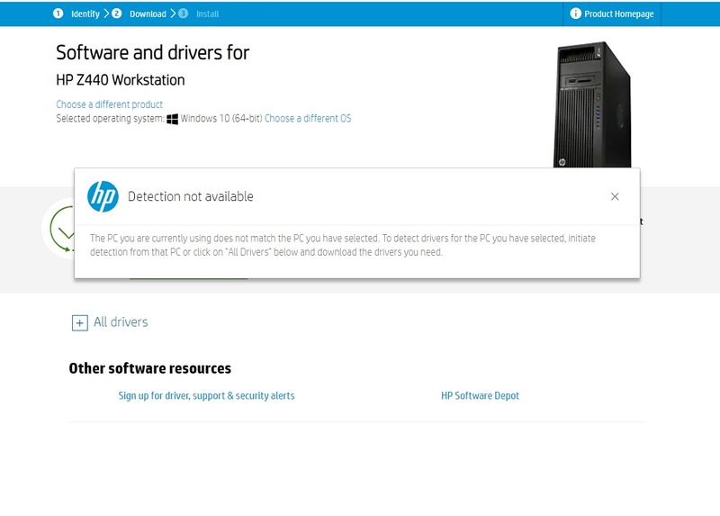

Thanks for your quick responce. I tried this but it didnt work. So I made an Acronis backup of the old PC, then installed clean windows 10 pro on a new HDD, installed Acronis on it, made a backup and imported the backup of the old pc. This worked for me. Windows opened as expected with all softwares and settings intact.
Now when I went to detect my PC from HP website it gives me the model and serial of old pc HP Z400, not the new one which is HP Z440. So I cannot auto detect my drivers or softwares from HP website. I am able to download and install manually without any issue.
I have been dealing with this for almost 3 weeks, ultimately gave up. Now who cares weather HP detects older PC or newer one as far as all my softwares are working perfectly.
