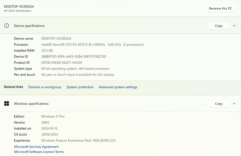

I can confirm that I today was succefull  to update a HP Z620  32 GB  from  Windows 7 Pro directly to Win11 Pro  on a dual boot system  with also Mint 21 installed using latest Rufus  4.6 Beta  using a 8 GB usb stick  and   I deleteted  all data on the same  booth drive on my SSD disk during the installation  .   Since I had the  linux as default  OS I have to use F9(booth selection)  to select windows booth  each time  windows 11 install  program want to restart  but  it worked . Very happy now .
i have Bios J6I V03.90 and believe that I  set  TPM to be active in BIOS but not sure , reading post I belive that I did otherwise it shouldn work .
So now i have a  dual booth sytem on my HP Z620 with both Windows 24H2 and Mint 21
Than all for the info here to make this happened  and what  a fantasic help  of  the creator of Rufus 4.6 Beta  are !
Lars
