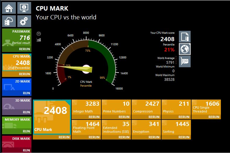

here's my benchmark - I can't see your image, it just shows a place holder. Its way under the rating listed on Passmark, trying to figure out why its so slow, just got the system.  What # did you get?
