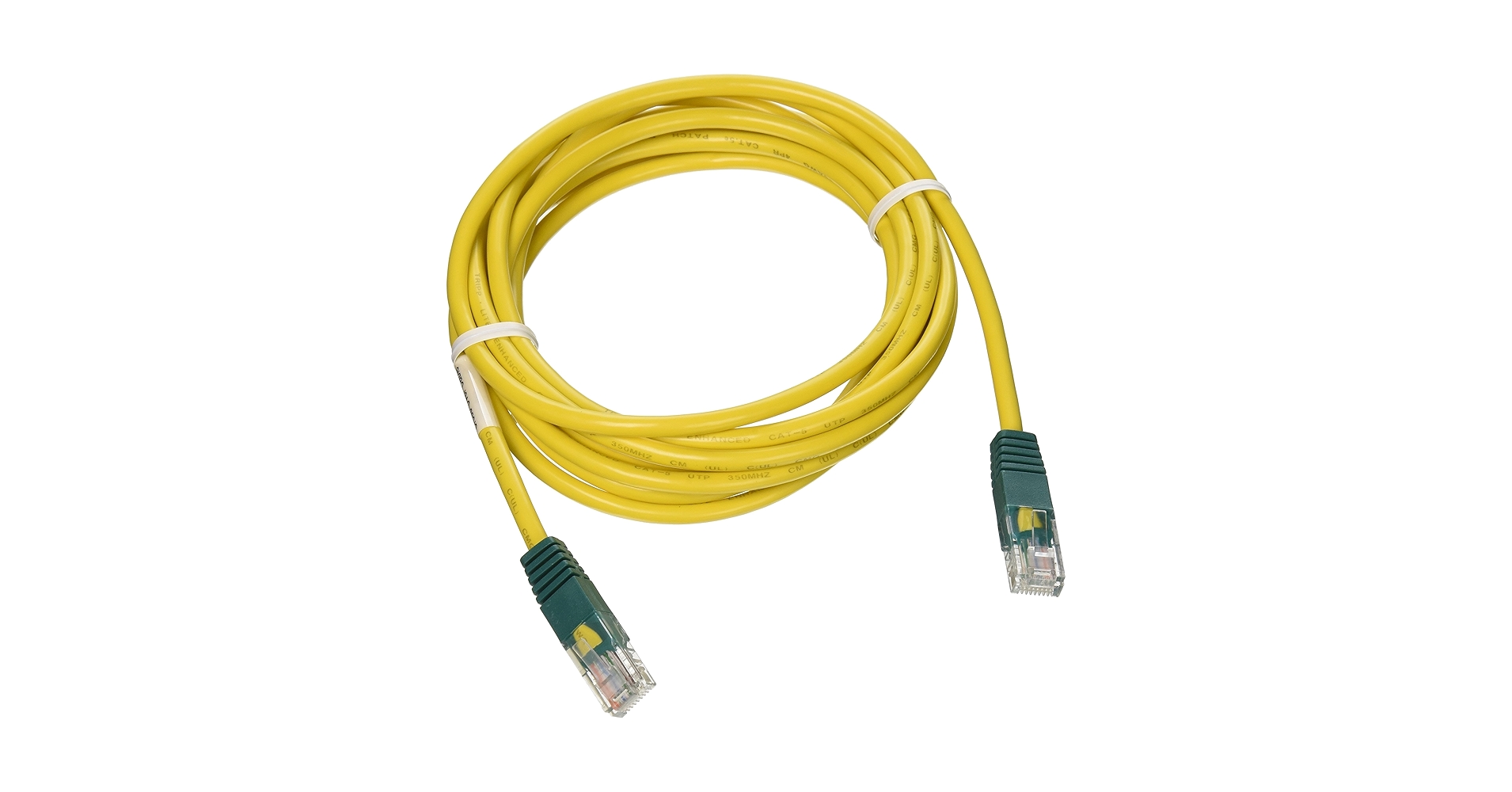

To access the EWS you'll need a cross-over cable like this:
https://www.amazon.com/gp/product/B0056YN7QE/ref=ppx_yo_dt_b_asin_title_o00_s00?ie=UTF8&psc=1
Connect one end to the printer and the other to your laptop ethernet port.  Ignore the USB port connection.  It won't do you any good.
The problem right now is finding the ISP address on your printer.  I'm assuming you can't get past the error on the front panel screen, correct?  If you can, the ISP will show up on the front panel once the printer is connected to the laptop. You'll probably need to go into the diagnosis or utilities menu to do that.  The service manual will tell you what buttons to press and in what order.  You might be able to find the ISP address in there.  You must hook up the cable first for the ISP address to show up.  My experience has been that the ISP won't show up until the two are connected.  It might be under a configuration menu.  Maybe someone else has another idea.
Once you get the ISP, type it into a new window on your browser.  No WWW or http prefix, just the ISP number (123.456.7.89 for ex.).  That will bring up the EWS screen.  I think you click on the "Settings" tab and the update firmware option should show up on the left hand of the screen.  You can download the file from there.

I don't have a cross-over cable but I can make one. I have all the tools to make my own Ethernet cables with CAT6 wire.
