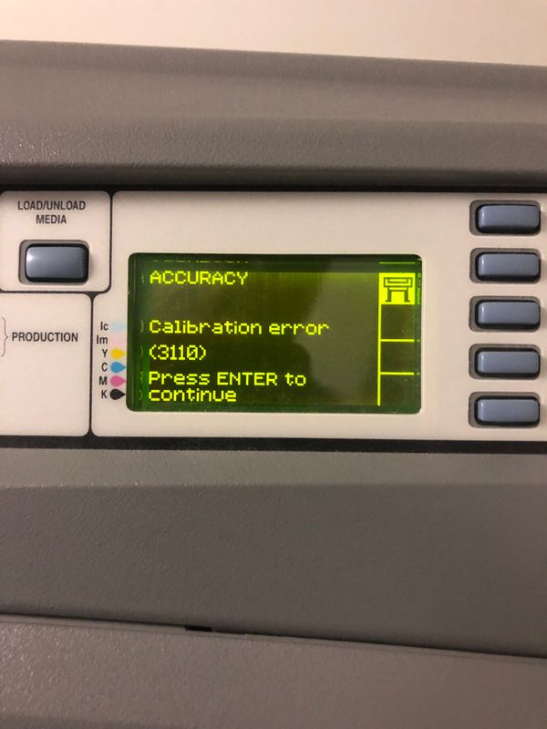

Well, I soaked the nozzles and tried to start up again, but same things happened - it automatically starts "calibrating printheads" but when it gets to 70% (and I believe working on Light Magenta) it gives the system error starting with a "0c0040" code.
However, on the next try, your advice of hitting "cancel" did successfully get past this "calibrating printheads" step, although the cancel took 7 or 8 minutes. So, I sent it a print job, which failed, but gave me a different error, see the attached photo?
Any new leads based on this error? I checked the tubes and cables to the best of my ability.
08-05-2019 04:59 AM - edited 08-05-2019 05:07 AM
Is it printing a calibration page? Can you post a picture of what's it's printing?
I'll look up the calibration error 3110 code and see what it says.
BTW, you say the error code starts with 0c0040. Is that the whole code that it's showing or is there more to it?
EDIT: Looks like there's a problem with the black printhead:
Calibration Error: 3110
Problem
Description:
Black Printhead does not allow paper advance calibration.
Corrective Action: Try the following:
Recover the Black Printhead ⇒ Page 6-15.
Replace the Black Printhead
Here's a webpage with the service manual in PDF: http://www.partshere.com/models/q1252a/q1252a_service_calibrations.pdf
