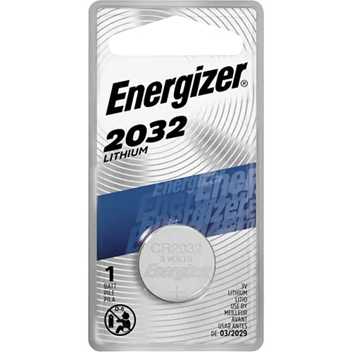

Are you inserting the replacement battery with the etched lettering "visible" ?
Hopefully, your replacement battery is not a "dud" battery.

I'm not sure what you mean by with the etched lettering visible, but the positive terminal + is facing up and the negative one is facing down, just like the battery before it, which was the original battery.
I don't know why tbe battery would be a dud, I could try another one but two others from the same packaging have worked perfectly fine.

@BadChecksum -- I'm not sure what you mean by with the etched lettering visible:
Sample image:   xc004.webp (500×500) (tenaquip.com)
of the etching.
I recently removed the 2 AA batteries from my smoke-detector, because it did not signal anything when I pressed the "test" button. Both batteries were installed, a year ago. One of them was totally corroded, and tested at 0 Volts & 0 Amperes. The other one tested at 1.5 Volts and 4.1 Amperes -- still "good".
A brand-new battery (same manufacturer and same lot) tested at 6.2 Amperes -- excellent!
So, in my case, one battery was a "dud".

Based on your image, yes the battery has the + terminal and the "etching" facing upwards, just like the original battery.
For all of those hard at work to resolve this problem on their own time, it may help you to know that I tested the original (old) battery and a brand-new battery from the same packaging and they both read the same on DC voltage (3.2) and mA (0.12) functions.  So, it would seem that the battery was fine and not the cause of the problem, which makes sense because changing it did nothing.
