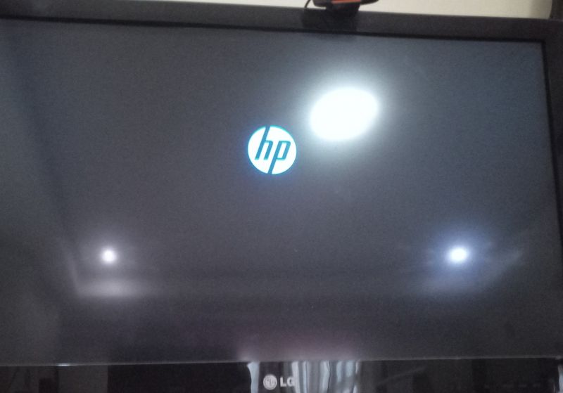

Boot freeze on HP Logo
Bios freeze on Main page only picture 1
Virtual assistant did not help. Hoping the Hp community can come up or help with the problem.
Key Board keys after Bios page on screen -Picture 2 and 3

Since the #2 screenshot shows "Network Boot" in the lower right, leads me to believe that something has interfered with the boot process and it is going though the list for boot devices.
Check for a card in the card reader or any other device IE: CD/DVD drive empty.  Disconnect all accessories except the keyboard and mouse - then try again.  If the same messages, then run the Diagnostics routine.
To run the Diagnostics routine, Start tapping the Esc key BEFORE starting the PC and then press the start button.
Keep tapping the Esc key until a popup menu shows. Then pick Diagnostics from that popup menu, F2.
Report back with the results.

Sir Thank you for your advice but unfortunately the advice you gave does not solve the problem. The Pavilion Mini Desk Top is a tiny unit with i5 processor which is fully integrated, No socket for processor, video card and other peripheral device.
Bios dialogue appears only when F2, F10,F12 are pressed during biit up but other than than other key board keys do not function at all'

But once again , the keyboard freeze after showing this bios on the screen
I am wondering is there something that blocks the full function of the keyboard to allow making choices and selection?
Did windows 10 update wrote error on the start up to prevent completion of the boot up?
I already made Bios recovery (Win logo+R+B) but the screen only goes to bank after completion
 I hope that somebody could come up with a solution to this problem
Granted what you suspect could have happened, but problems similar to the one in discussion usually happen because the hard drive has failed.  In looking further, that PC is different than most but it still has a SATA hard drive, 2.5".  In most cases the drive needs to be replaced, and then everything (software) needs to be reinstalled.  If the PC itself will not run the diagnostics, then probably the next best thing is to remove the drive and test the drive with a different PC while using a SATA to USB adapter.

I am already thinking of Replacing the Hard Drive. Fortunately the unit socket can accommodate  SSD M2 with B keys. I will do that and I will let you know what happens. Hope that the Bios Flash section is in good condition, i think that we can resolve the problem.
Hopefully that will solve the problem.

One solution on the web i found is to replace a cmos battery. Is old SCMOS battery related to freezing BIOS?
The usual symptoms of a failed or failing CMOS battery is the time and date will be off and there is normally a warning about the BIOS being reset to defaults to allow the computer to boot up.
One thing I should ask -when starting up, the screen that shows the HP logo, does it do anything else?  Or does it just not do anything after the HP logo, and then show those screen shots you posted at first?

when the HP logo appears on the screen. It does not do anything else. Just frozen like that.
