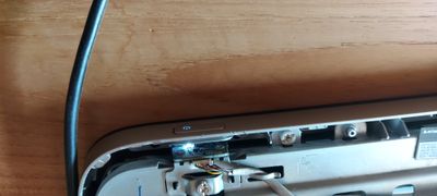

So what's going on is that the pc has power. The power led turn on when I plug in the power cable. When I press the turn on button on the top, that led turns on as wel. But nothing inside the pc starts spinning or turns on. The screen also stays black and ofline. I have experienced this for over a year now. And normaly it starts back up after I do a wierd thing to it I'll leave my pc (on) like that for 30min. Then I hold the power button for 2 seconds so the (on) led turns off. I'll keep it off for like 30min as wel. After that I would turn it on again for around the same amount of time. Then off again, but now I would turn it back on right after holding the power button for 2 seconds and it turns alive again. I know this is not normal lol. But these periods of not responding are getting longer and longer. I toke of the back of the pc to look at the motherboard... the first looks does not shown any signs of a lose fable or a burned capasitator/damage. It does feed power to the motherboard as the 2 different led lights turn on on the opposite side of the board. The power light and the turned on light.
Here are 2 photos (cause I cant send the video) where you can see the power being on. PC being turned on but nothing els works.
