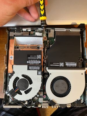

Hey I just did the same thing and bought the RX560. Got no power to the unit when plugged in, does your motherboard have a piece right here? (See image) mine does not but it looks like the card needs to plug into something right here. Any help would be appreciated
