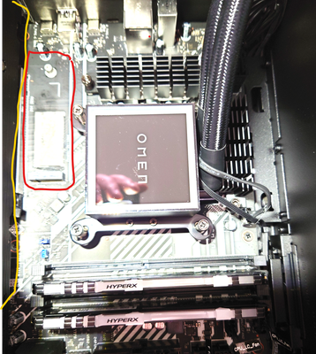

My case looks like this:
Marked in red is the SSD M.2 slots, and they are above each other, so you should stack them it seems.
I removed the installed M.2 and it was a cooling pad attached to it covering the slot below. I could not put the existing M.2 SSD in the below slot as well (yes I removed the cooling pad) as well as the new one. It seemed to be too long and wouldn't come in place.
The yellow is the RTX30xx card.

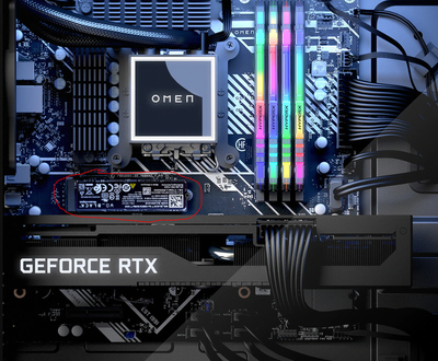

Hello. Thanks for sharing your experience.
Is this the one you bought?
Alongside this heat sink?
It seems that the hard drive has already a heat sink?
You installed on your 45L on the socket just below the CPU, correct?
OmenArne
As I understand your are misunderstanding the situation
Both slots are not supposed to be stacked on each other in the same place.
One slot you can see just below the CPU as your picture shows.
The other one should be hidden below the GPU.
both should be the same type as I understand.
... so in your picture is just one ssd slot marked in the red area.
