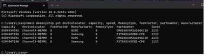

run the following with the new memory and with the old memory and report back the results.  It would also be useful to know the model of your PC.
An easy way to find what memory you have is to run the wmic app from the windows command prompt. Bring up the window CMD prompt and enter the first line to see what memory you have. The second line may give the maximum memory possible based on the chipset. The number of memory sockets limit what can be added.
wmic memorychip get devicelocator, capacity, speed, MemoryType, formfactor, partnumber, manufacturer
wmic memphysical get maxcapacityEx, MemoryDevices
Should look something like the following. To purchase identical memory search for the part number shown and look for the letters 'HP' on any label attached to the memory stick.
The above values are in bytes. Divide by 1024 twice to get megabytes.
8589934592/(1024*1024) = 8192mb or 8gb
The output of maxcapacityEx is Kbytes, not bytes.
Note that some older systems do not recognize maxcapacityEx even when running latest Windows.
Let me know what you find out.
