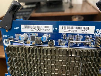

Yes i have the 2 nvme2 installed on 1 card. I attached a picture of the holding card with its serial number
Then, I don't know what to tell you -- as the only explanation is that this lowering of the speeds of the second SSD must be a feature of the card.
I am a volunteer and I do not work for, nor represent, HP
Yes can you tell me which card is correct for me from hp z8 manual specs
Sorry, I don't have that information but my guess would be that either model card, the Quad or the Duo, would work the same in your PC.
