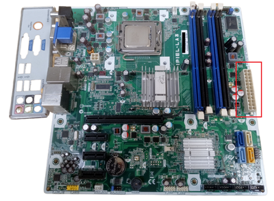

Information regarding your desktop is somewhat challenging to come by. Anyway, if your motherboard resembles this one:
Then you could swap your current 24-pin based ATX power supply with a higher wattage PSU.  You may want to consider that, as higher end GPUs require more juice and PCIe power cable(s).

Thanks for all the info, that looks just like my mother board and the info you provided is going to be very useful. I had my own thoughts on what to go with and you just confirmed what I was thinking about. Thank you very much.
