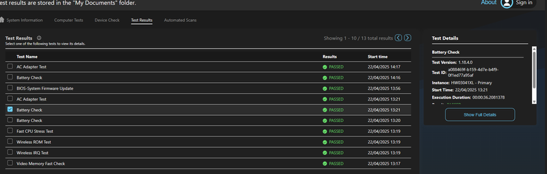

The battery does not charge past a certain percentage. The first time this happened it was 100% and it went down to 34% (I don't remember if it was connected to the AC when it went down to 34 percent). It was stuck on 34% even when charging, I tried fixing it by letting it completely run out of battery and then plugging it back in the charger. This time it only went up to 3% and stayed there. Btw; I'm using the laptop while it's charging. If I don't charge it, it will run out of battery and shut down.
I have ran the hp pc hardware diagnostic windows 2.7.2.0 tool for everything such as battery cpu ram etc. and it says everything has passed the tests including the charger (which is the official hp charger)  but still the issue remains. I have let the computer drain to 0 percent and charged it for about 10+ minutes and it only reached 3 percent. Here is the battery report html for the last three days. As i am typing this the battery went down to 2 percent on charge.battery usage over the 3 days (yesterday this problem happened as you can see)battery usage over the 3 days (yesterday this problem happened as you can see)diagnostics test resultsdiagnostics test resultsthis is the capacity when i first had itthis is the capacity when i first had itthis is the capacity as of nowthis is the capacity as of now

Thanks for the reply. It randomly started charging again after giving several warnings about the battery being faulty and needing replacement. However, it's now working. Before that, I had uninstalled and reinstalled the battery drivers, did a hard reset, and drained the battery. After all that, it started to charge — interestingly, right when I was looking for a battery replacement. 😅
At the time, it was showing errors during my checks, then suddenly began charging again. As of now, it's been working fine. I'll just go with it until another issue comes up. For now, it's working again.
