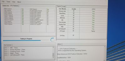

 I downloaded official Intel Processor Diagnostic Tool, and it didn't pass the test. The System hung right after the integrated GPU stress test

I talked with a technician from HP today and showed him over the remote how PC behaves. It reached 98C and didn't pass through the Intel's "Prime Numbers" math test. This guy seemed to be technically fit, and promissed me to get in touch with the service to explain them how actually bad the things are... So I will wait how it evolves further.
