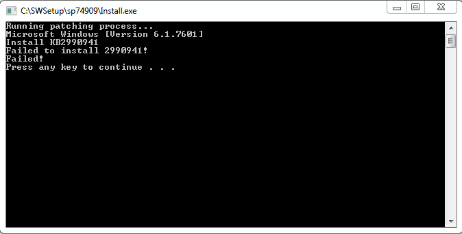

Thanks, i tried to install it but it pop up an error of KERNEL32.dll, later on i installed windows Automate installation kit and then trying to install KB2990941, but unfortunately faild to do so. I'm attaching screen shot for you kind consideration.
You're very welcome.
Sorry the automatic installation didn't work.

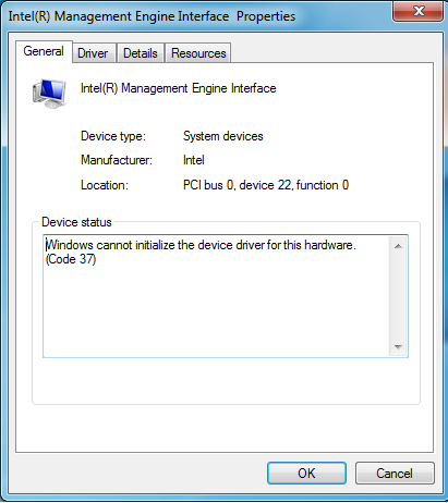

Thanks, The driver has been installed however on device manager it still showing a warning
"Windows cannot initialize the device driver for this hardware. (Code 37)"
I have another machine where windows is running and the installed driver don't know when it is installed is working fine, is there any way i can copy the driver from there.
Device_driver_fail_to_intialize.pngDevice_driver_fail_to_intialize_managment_interface.pngdriver_from_another_machine.JPG

Unfortunately, I wouldn't know how you would be able to do that.
You may want to try one of the older Intel Management Engine Interface drivers from the support page.
Look under the Previous Version section.   There are six previous versions to choose from.
https://support.hp.com/us-en/drivers/selfservice/hp-z240-tower-workstation/8354563
