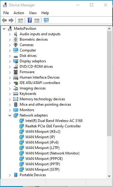

Thanks krzemien,
network card in my Pavilion is an Intel Dual Band Wireless-AC 3168 - this has proved to be 100% reliable, no issues to report there.
The screenshot below shows absence of Bluetooth and presence of network adapter.
Thanks for looking into this problem.
Thanks.
AC-3168 card is both PCIe (fitted via M.2 slot) WiFI AND Bluetooth card.

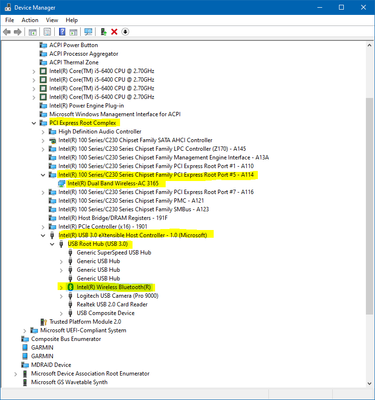

I find it unlikely that one part of the card works, and second doesn't but who knows?
Intel's AC-3165 in my Omen is kind-of similar (it's merely previous generation of the same solution).
Bluetooth adapter therefore should appear under USB controller, like in my case:
Whilst in Device Manager can you got to View -> Devices by connection and provide similar screenshot - especially around USB devices?

the equivalent Device Manager screenshot you suggested is shown below (View -> Devices by connection). It seems to be consistent with the other views, in that no Bluetooth is present.
I think the hardware is ok - there was a brief moment when Bluetooth was visible in Device Manager, albeit greyed out and only displayed when "Show hidden devices" was on. I forgot to get a screenshot when it was there.
I think it became visible after a BIOS update, but as it subsequently disappeared again I don't know if the root cause of this problem is the BIOS, Windows 10, or a combination of the two, which is why I've turned to this forum in the hope of someone more qualified then me getting to the bottom of it.
