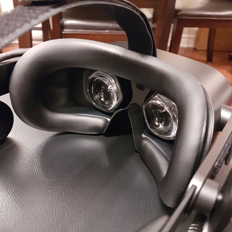

Hi!
I bought the HP Reverb G2 Wipeable Gasket 3 Pack. Part Number: 22J69AA
Does anyone know how to install the rear headpad?
The front facemask holds with magnets but the rear headpad seems to hold with plastic tabs and I can't find instructions or online video on how to safely remove and reinstall the rear headpad.
Thanks!
Ok, I found these instructions showing how to remove and install the rear headpad included in the HP Reverb G2 Wipeable Gasket 3 Pack. Part Number: 22J69AA
No need to remove the entire headset strap. To change only the rear headpad, I followed steps 1 to 5-e and steps 18 to 21 (I skipped steps 6 to 17) using the following procedure:
https://support.hp.com/document/ish_3883513-3883575-16
The result:
