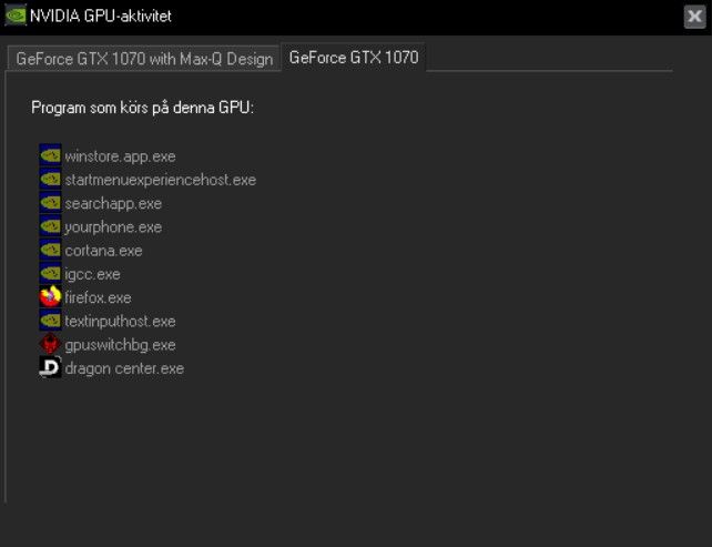

I understand that I've explained my problem poorly. I've been thru the checklist a couple of times and tried to reinstall the drivers and so on. But it didn't help, at least not the way I did it.
The app still gives med two error message: Realtek Lightweight Filter driver is not installed or failed to load.
and: Omen Accelerator couldn't be found.
As you can see below, the graphic card works fine after a couple of tries and Intel’s thunderbolt software finds the Omen Accelerator.
My problem is: that the app doesn't work and that I can't use the usb-ports on the Omen Accelerator without extreme lag.
Maybe there is something obvious that I missed.
