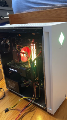

Hi support community,
Recently, I have had issues with my PC's power supply, but after that has been fixed, another issue has come up. The RGB on the CPU cooler and front bezel stopped lighting up, and I do not know why. The RAM still lights up fine and I can control it in OMEN Gaming Hub, but the other RGB lights stay dark no matter what I do in Gaming Hub.
Right before the original power supply that came with the PC died, it boot looped with all the correct RGB colors and they all lit up. After the original power supply died, I used an older 500W power supply from another build to test the system, make sure everything was working. The system continued to boot loop, which I figured was because it was missing the correct 8-pin connector needed for the GPU. The RGB lights were also different from the original colors. The normal white on the front bezel turned to a bright green, and the normal green on the CPU cooler turned to red. I thought it was maybe just the system trying to display error codes through the RGB. I ordered a new PSU, and installed it into my PC. Everything worked fine, but the RGB stopped working. I'll attach some photos below so it's easier to visualize what's going on.
The image above is what the RGB is supposed to look like. Green for the CPU cooler, white for the front bezel.
The image above is what the RGB looked like when I tried to power on the computer with an old PSU I had laying around, but it didn't have the 8-pin GPU connector so it kept boot looping. The CPU cooler is supposed to be green, not red, and the front bezel light is supposed to be white, not green.
The image above shows what the RGB looks like now. There are no lights for the CPU cooler or front bezel, no matter what I try. The CPU cooler looks light it's lighting up blue, but that's just reflections from the RAM sticks' RGB.
If anybody has a potential solution, please guide me through! I'm very lost even though I consider myself rather tech savvy. Thanks in advance!
