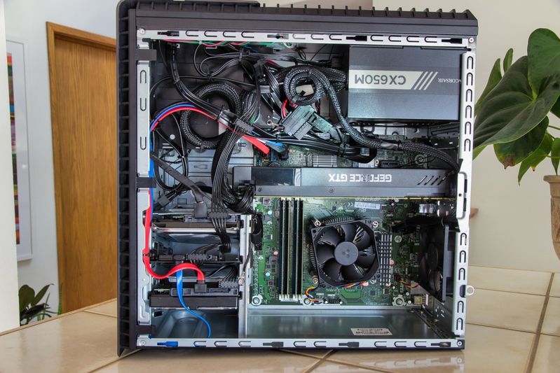

I put a EVO-970 1TB SSD (M.2) and a EVO-860 1TB SSD (SATA) in this PC (HP 870-244 Omen).  The graphics card has to be removed to access the M.2 slot.  You can see the SATA SSD (blue SATA cable). The SSD is 18x's faster than the HDD and the PC will boot in 11 seconds.
M.2 slot with the graphics card removed...

I got the screw at Ace Hardware (M3x50).
Two screws to take off the mount holding the graphics card. The one on top is obvious, the other is adjacent the optical drive (follow the ground lead to it). After replacing the PSU (mostly due to a more attractive cabling option), I opted not to reinstall the mount since the card felt secure. May be overkill for shipping purposes but definitely ugly. The EVO-970 is the way to go; Deals on Amazon show up from time to time. It makes a huge difference in the overall performance of the PC, just making it feel "snappy" as apps load and exit faster. A Windows update takes seconds instead of minutes. However, what I like best is, I can immediately start using the PC after it boots. No lag as other programs load.
