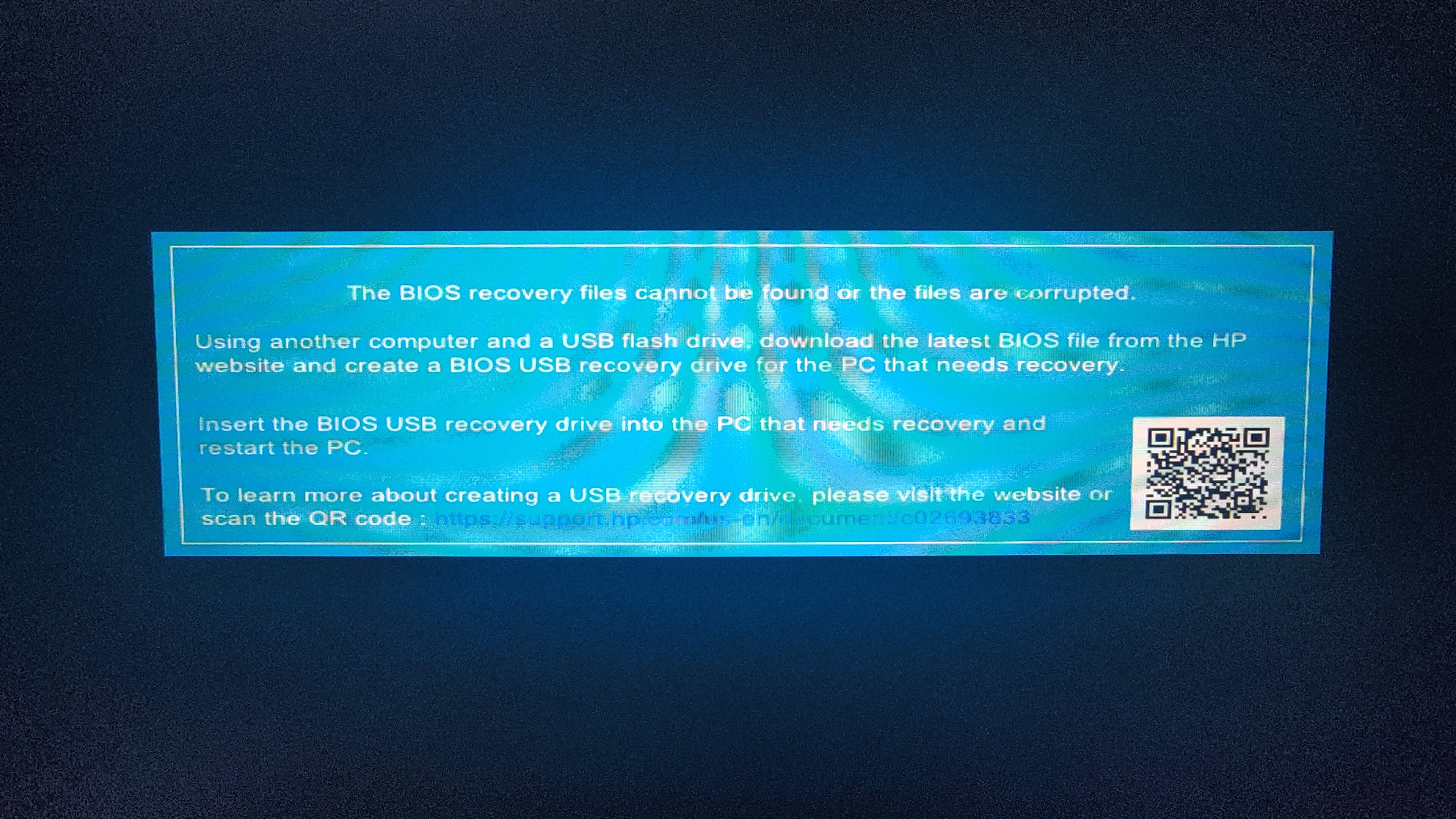

In this Thread is a Link to a YouTube-Video with a solution but when I tryed to do what HP said in the video, the shown method does not work on HP Victus 16. I even tryed it with different USB-Sticks and with different formats (FAT, FAT32, exFat) but it only shows me this: https://s1.directupload.eu/images/250819/p6ujyz3q.jpg

I already resetted the BIOS (a few times) and recovered it (one time).
I even made a USB-Stick (actually I made two because I wanted to rule out the USB stick as a potential source of error) with the file named sp155860.exe
This is the file the HP-Support-Website gives me when I search for older BIOS-Versions with the serial-number of my Laptop.
I even installed the HP Support Assistant but there are no new Updates for my machine.
Oh btw I need to say that this programm looks more like a marketing-tool, trying to sell me HP-Stuff and antivirus-programms than having to do something with actual support.
Here is a screenshot from creating the USB-Recovery-Stick with F.26
and here is a screenshot when I booted from the USB-Drive and trying to open a efi-file (secureboot already deactivated and I can see the folders HP and Hewlett-Packard and all the efi-files).
Are there any more methods I could try?

Got it — thanks for sharing the screenshots. They’re very helpful.
Here’s what’s happening and why you’re hitting the “Selected boot device failed” error when trying to use the USB recovery stick with the F.26 BIOS file:
Why it’s failing
HP BIOS rollback restriction
On many Pavilion/Envy/OMEN systems, once you’ve flashed a newer BIOS (e.g. F.29), HP sets a rollback lock in the firmware. That’s why the tool says “This BIOS update is not compatible with this device” when you try F.26.
The USB stick is being made correctly
Your screenshot shows the HP BIOS Update Utility creating the recovery USB. The presence of the HP and Hewlett-Packard folders + .efi files means the stick is structured correctly.
Boot error message
When you select the USB to boot, UEFI firmware checks the .efi bootloaders. If the BIOS build on the stick doesn’t match the allowed rollback versions, the firmware just refuses to boot it — resulting in “Selected boot device failed”.
