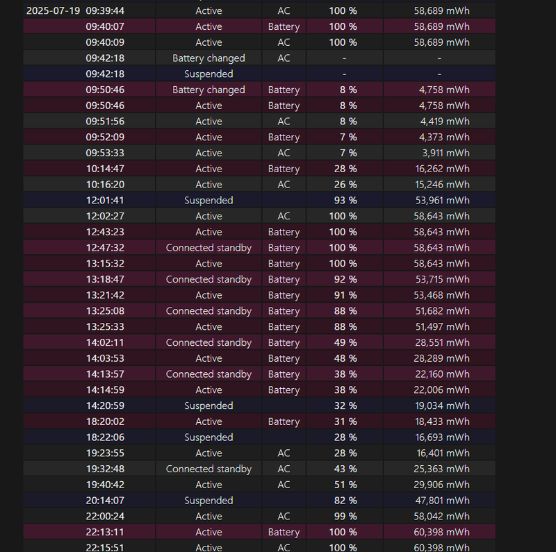

I own an HP Victus 15-fb0xxx (Ryzen 5 5600H, RTX 3050, Windows 11). Recently, after cleaning the laptop's vents (without opening the battery or touching internal cables), the BIOS and battery report started showing incorrect battery values:
  • Design Capacity: 12,997 mWh
  • Full Charge Capacity: 12,997 mWh
  • Cycle Count: 120
However, under actual usage, the battery still performs normally and Windows logs show correct readings around 58,000 to 59,000 mWh — which matches what I used to see before. So, this seems to be a firmware/EC misread and not actual battery degradation.

  3. I didn't even changed battery but on 19 it is showing I changed it.
  4. Screenshot 2025-07-23 201128.pngScreenshot 2025-07-23 201137.pngScreenshot 2025-07-23 201147.pngScreenshot 2025-07-23 201204.png

Thank you for letting us know, and we appreciate the detailed report regarding your HP Victus 15-fb0xxx laptop. You've done an excellent job already with the troubleshooting steps and based on the information you've provided — particularly the discrepancy between actual battery usage values (~58,000 mWh) and the misreported design capacity (12,997 mWh) — we agree this appears to be an issue related to Embedded Controller (EC) firmware memory, not battery degradation.
