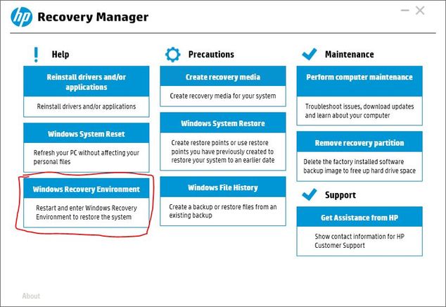

Go to Start and scroll down to H / HP Help and Support and open the HP Recovery Manager.
Choose to restart the system in recovery mode, then follow the prompts. You want to recover back to factory condition, dont choose to have it save your files or such. You want it to wipe the OS and start over.
Usually a re-installation will clear up odd occurrences like this.

Before you install anything, I would suggest doing a factory reset, which will reinstall windows.
You can run the reset from the start menu.
