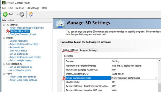

Did you also make sure the Nvidia control panel is not set to use Preferred graphics processor in Auto Mode? If you have that option, make it set to the Nvidia card only.
Also try setting the global settings tab in 3D Settings to power management mode > prefer maximum performance. Even if your battery is removed, I have seen this setting make a difference for a couple of users.
