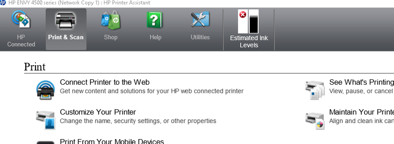

When I have no ink cartridges in the printer I have below message:
"Cartridges appear to be missing"
So the printer can detect for presence or non presance of a cartridge for both color and black.
When I load the color cartridge only:
"The following Ink Cartridge (Color) must be replaced"
When I load the black cartridge only:
"Printing in single cartridge mode"
So this leads to root cause of:
1. Color Ink cardtridge.
2.Software or Firmware PREVENTING use of the Color Ink Cardtridge.
I have 3 NEW Color Ink Cartridges.
I tried all 3 - I still get the same message :
I have already forced the printer in hardware diagnstics mode to print in color for:
1.Printer Status Reports
2.Print Quality Diagnostic Reports
So my final Root Cause is:
******Software or Firmware preventing use of the Color Ink Cardtridge******
Please confirm if you agree with my root cause analasys and advise nest steps to try.
Photos and scans attached.
Kind regards and thanks,
Mossyh
No cartridges installed
Black Cartridge Installed
Both catridges installed
Black cartridge Installed
Color Carridge not detactable 1
Shoing problem with color ink
Hardware test on the printer -Printer Status Report - the Printer diagnostics menu
Printer Quality Diagnostic Report made thru the Printer diagnostics menu
