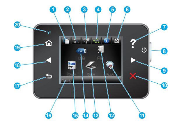

The question mark on the display screen is stuck. I’ve unplugged it in all different combos and uninstalled it on the computer. Nothing works. It turns on, gets halfway loaded then blank screen and the lit question mark

This icon will be lit as per the printer design.
7 - Help button: Provides access to the control-panel help system
Refer to the printer manual for more info. Click here.
