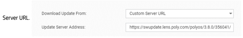

  • To set a Custom Server go to paired codec WebUI > General Settings > Device Management, and set Download Update From: to Custom Server URL.
  • The update Server Address should be set to the correspondent URL of the version the customer would like to use:
