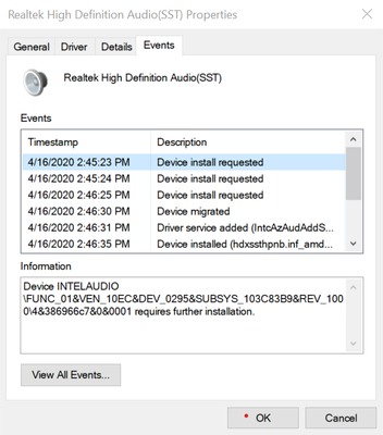

The device in Audio Input and Output is now migrated, but I still do not have any sound playing. I checked the Sound, Video, and Game Controllers tab, and I found another "issue". Mainly it just says "Device install requested". I tried to update the driver via the Device Manager tab, but it already said it was up to date. I then tried to uninstall the sound, and then re-install it again, but the same message appeared about an install being requested. To make matters worse, the message "device not migrated" message appeared once again under the Audio Input and Output tab, so I reset my laptop again .
Now I am back to square one.  I just wanted to ask if I need to download the audio driver from HP in order for the "device install requested" to go away.
Also this is what I am seeing in case it will help.

I downloaded the support assistant and checked for updates like you said, but there weren't any related to the audio. The only update I had was for the HP PC Hardware Diagnostics UEFI. I even checked for window's updates as well, but it just said my computer is up to date.
I went to the software and drivers tab on the HP support site and downloaded the audio driver :
Realtek High-Definition (HD) Audio Driver (Windows 10 V1709/V1803)
6.0.1.8536 Rev.B
The device is now supposedly installed, but it says "Device Configured Null".
