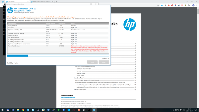

There is a new update available:
SP95855 dated 24. April
This Update worked fine for me after all the problems of SP93495. Two audio modules now have the new firmware and work.
Perhaps you need to install the new audio drivers before: SP91938
(Tested on a HP Elite x2 1013 G3 with all HP updates installed and Windows 10 1809).
Ok, thanks for the heads up @Christiankr - I checked last week and this 24th April update wasn’t there then !
Ok, first the good news:
- This does fix the Audio issue for me.  The firmware now applies from MacBook Pro.
- This also appears to fix an issue with my MacBook Pro where 4K 60Hz didn’t work on the recent firmwares (but 4K 50Hz did - go figure).
The not so good news:
- This firmware *still* doesn’t apply cleanly from my Thunderbolt 3 MacBook Pro.  The Audio bits apply cleanly, but it includes 7 newer firmware versions than were installed on the dock.  The USB-PD firmware updates don’t apply for me - as soon as they start applying the dock goes into an unresponsive state.  Eventually the updater times out, but I need to pull the power on the dock to get it back to normal.  Fortunately this doesn’t misapply the firmware unlike the audio problem that started this thread (after pulling the power the old firmware is still present) - but it’s still irritating that this firmware pack doesn’t apply properly.  I’ll need to try another laptop, but at the moment my USB-PD upstream and downstream, and thunderbolt firmware, are still out of date.
