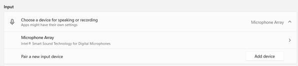

I followed your instructions with the minor modifications of selecting the most "recent" driver update(s); and I'm happy to report that it did indeed work!  Prior to the screenshot (below) it would display "No device."
My final result:
