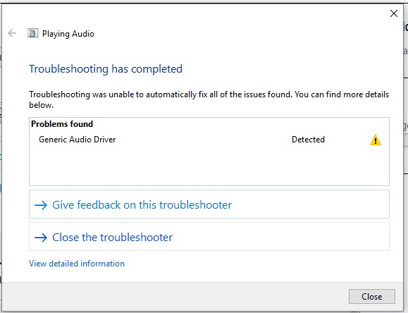

6.  I click the headset to be troubleshooted. There are two options, one for the speakers and one for the headset.
7. While resolving the issue for a few second sound comes from the headset but when the final window is shown, the sound comes from the speakers again. (I will attach the final window with the problems found.)
8. I close the troubleshooter and now the sound comes from the headset.
undefined
9. Now if in step 6 I click for throubleshooting the speakers I will get this window:

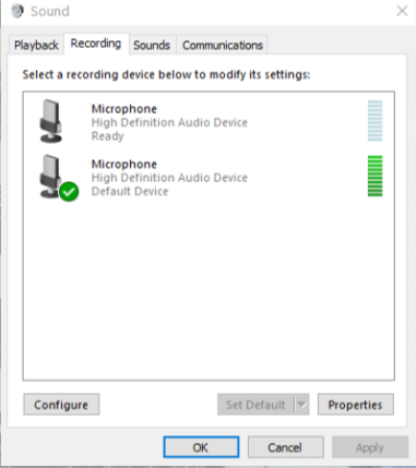

  • In recording devices I have two devices, one for internal microphone and one for headset microphone so there is no problem in recording devices and I can switch between two microphones without any problem.

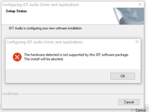

NEWS: I have read somewhere that someones have resolved the issue by installing tha latest IDT driver from the hp site in compatibility mode with windows 8.1. So I tested this way. I right-clicked on Idt sound driver exe and went to properties. In compatibility tab I checked "run in compatibility mode for:" option but in windows there was no windows 8.1. So I chose the windows 8 and applied. Then I opened the exe file for installation but during the installation it gave me the error shown in the image attached. So I couldn't test this solution. Any idea?
