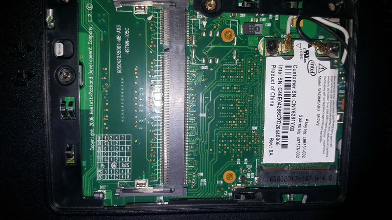

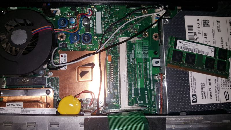

Hello thank you for your respons on my problem with the power on password blue screen problem.
I followed your steps but i can't find what you mention on your picture? I took two foto's and then you will see that it is not the same model like yours.
Thank you,
@DjChaese78
Many of those older models have a set of jumpers like that.
But on yours I can see it does not.
