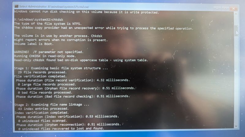

symptom: BSOD
Boots into windows, freezes within 1 minute, BSOD
Tried Chkdsk, tried diagnosis, tried a lot of different things.
My initial thought...possible SSD failure?
wear percentage = 2
Does that mean it's almost dead? Or still very healthy?
I also don't understand how diagnosis shows 2 SSD drives...when this laptop only has 1 SSD?
Thank you for any help and suggestions.
PXL_20240922_103114104.jpgPXL_20240922_103246360.jpgPXL_20240922_104312037.jpgPXL_20240922_111513237.jpgPXL_20240922_130640424.jpgPXL_20240922_145852784.jpgPXL_20240922_154444212.jpg
