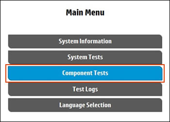

Use the HP PC Hardware Diagnostics tool for Windows to identify AC power adapter issues.
  1. In Windows, search for HP PC Hardware Diagnostics for Windows. Right-click the app, and then select Run as administrator.
    If the app is not installed on your computer, download the latest version from the HP Hardware Diagnostics website.
  2. On the Main Menu, select Component Tests.
    Selecting Component Tests on the Main Menu

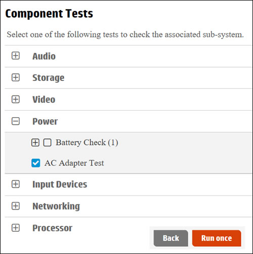

  3. Select Power, select AC Adapter, and then click Run once.
    Selecting Power and AC Adapter
  4. Wait while the test is in progress (approximately two minutes).
  5. Click Finish, select Test Logs, and then review the test results.
  6. If the test result is PASS, the power adapter is working. If the test result is FAIL, the power adapter needs to be replaced.
