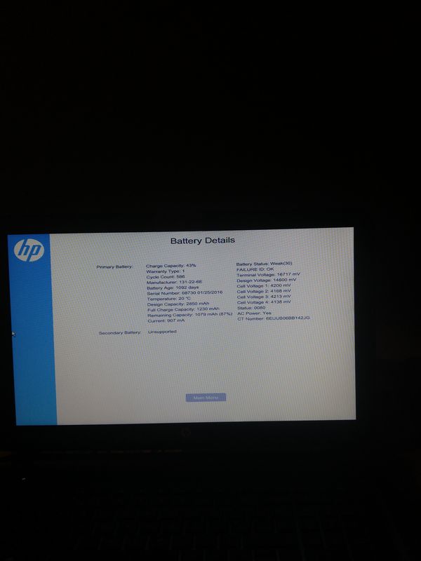

So, recently my battery for my laptop is not performing well. I have made all the necessary to power setting but nothing is working. to to be clearer, my battery was performing as expected (good and holding charge etc) but now the laptop battery would be on 100% but after 30 mins or sometimes less the laptop shuts down without any warning. I have set the low battery setting at 30% warning but it never reaches that stage.
Therefore, I am providing the following pictures I took of the battery test today (21/01/2019).

Regarding the BIOS setting, I will have to get a hard drive to back up all personal data. In the meanwhile.....
The image attached shows the battery charged to 100% then unplugged the AC charger.
the percentage is on the tight followed by
the current time for the percentage and lastly
what the system had said for the time remaining
weird thing the laptop SHUTDOWN at 60%
I came to a conclusion, the laptop's battery is definitely not able to hold the official charge any suggestions?
@Stark_Legend
Thank you for posting back.
Let's run a hardware diagnostics test on battery:
Use the following steps to open the Component Tests menu.
  1. Hold the power button for at least five seconds to turn off the computer.
  2. Turn on the computer and immediately press Esc repeatedly, about once every second. When the menu appears, press the F2 key.
  3. On the main menu, click Component Tests.
  4. The Component Tests menu displays. Your Component Tests menu might be different, depending on the components installed on your computer.
  5. To run both tests simultaneously, in the Component Tests menu, click Power Source, and then click Run once. Each component can also be tested individually.
Battery Test:
Follow these steps to perform the Battery Test:
  1. In the Component Tests menu, click Power, and then click Battery.
  2. Click Run once. The Battery Test begins.
  3. When the battery test is complete, the results are displayed on the screen. For additional battery information, click Battery Details.
