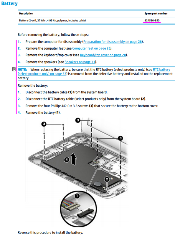

(2) Service / Battery replacement
--->>> Maintenance and Service Guide
Page 34 Chapter 5 Removal and replacement procedures for authorized service provider parts
HP warranty valid -> Contact HP Support for service repair
