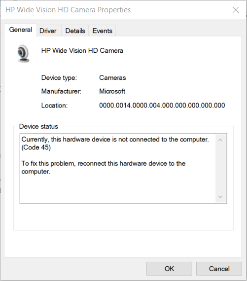

My in-built camera was working fine, but all of a sudden stopped working after I update the app on the Windows store.
The following are the screenshots I get when I tried to resolve the matter.
I got a fix to this issue from the below post... Decided to copy it in here for the benefit of others. Thanks to @Eddyk for the post.   Camera not found on HP Spectre x360 or HP ENVY (x360) | 0xA00F4244<NoCamerasAreAttached>
