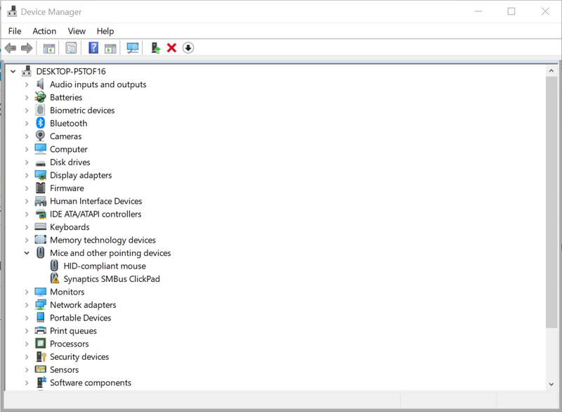

Hi,
I was attempting to follow your steps, but I noticed that during the deletion of the driver software, the following screens occur after restart. The Windows update troubleshooter and HP Support assistant did not have any further updates to install

@Baseballf92LBK,
According to the error code 10: The device cannot start (for example, it is missing or is not working properly). This message can vary greatly because the text for this message can come from the driver.
To resolve this error code, make sure the device is attached to the computer correctly. For example, make sure all cables are connected firmly and that all adapter cards are inserted into their slots fully.
Follow the suggested solution button and update the device driver. It might be possible to remove the device and re-detect it automatically.
If the issue persists, as suggested please run a test on the touchpad from F2.
1. Hold the power button for at least five seconds to turn off the computer.
2. Turn on the computer and immediately press Esc repeatedly, about once every second. When the menu appears, press the F2 key.
3. On the main menu, click Component Tests
4. Select Mouse/Touchpad and run the test.
Let me know the outcome!
