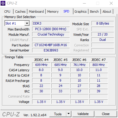

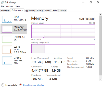

Sorry, yes, it is an HP 15-BA009DX. Does it utilize dual channel ram mode? That is where my confusion lies. Both sticks of ram are exactly identical, they were packaged together, but as show in image 1 my computer seems to not recognize their dual capabilities. As shown in the task manager shouldn't the speed be rated at 1600 MHz if they were both recognized as such?

Your model, since it has an A6 processor and uses DDR3 memory...the memory runs in single channel mode regardless.
See the service manual, chapter 1, page 2, toward the bottom of the page.
http://h10032.www1.hp.com/ctg/Manual/c05227786
The 'Dual" in your screenshot report refers to the number of ranks the memory has.
There is single rank and dual rank memory, and that has nothing to do with single channel or dual channel.
