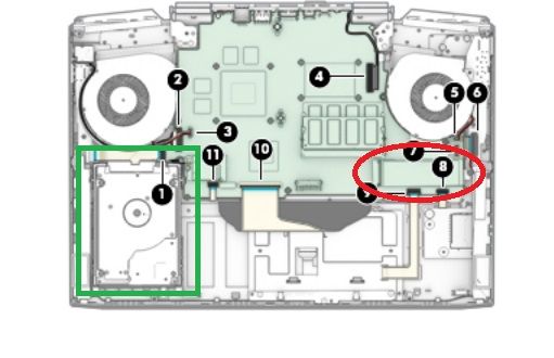

Here is the Service Manual:
Manual
Good aerial shot of the internals:
M.2 slot = red HDD = greenM.2 slot = red HDD = green
The only storage slots are noted above. There is a place to insert a memory card like you use in a camera on the left side. There is not a DVD drive bay you could use to add another hard drive. So right now all the practically available storage slots are in use by your hard drive and 256 gig PCIe/NVME M.2 disk.
