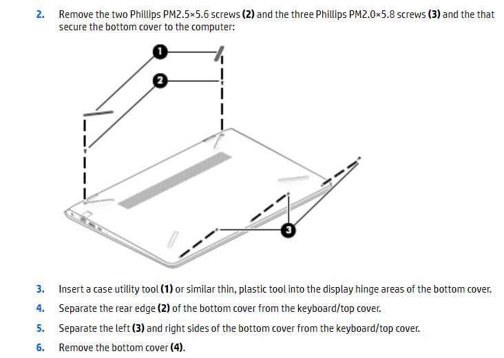

Thanks, but i can't open the laptop, i see 3 screws and i can unscrew but then the cover does not want to be removed... its so hard!

The Manual link works for me. Try this:
http://h10032.www1.hp.com/ctg/Manual/c05705784.pdf
There are screws under the rubber strips on the bottom. Remove the strips carefully and do not stretch them. You may need to use a drop of rubber cement to reattach.
rear cover removal instructionsrear cover removal instructions
