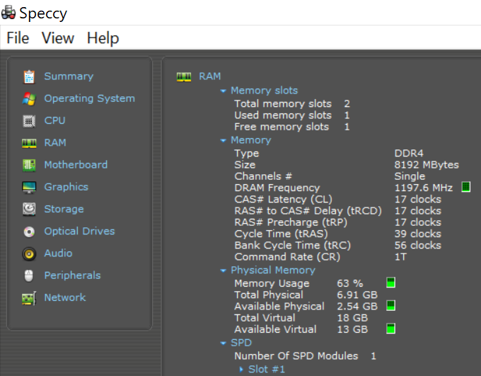

I typed this command line, cmd, enter:
"wmic memorychip get devicelocator, capacity, speed, memorytype", enter, and here it says 2400 MHz.
Was this checked by the computer diagnostically? Then this will be the exact value, but I was completely unsure.
I think the sure thing is that I will take the notebook apart and look at the type, I hope it can be identified.

I'll report the result later, I'm already very curious because of the contradictory data. I just checked with two RAM diagnostic software, CL=17 for both. HP Parts wrote 19 on the current Samsung RAM.
