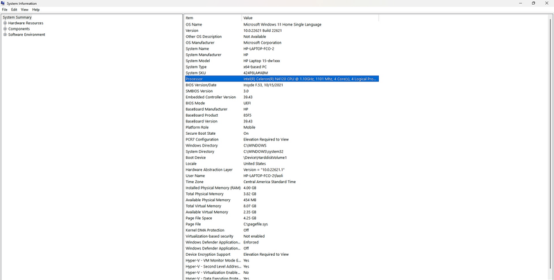

Thank you for the info. Please, how do I know the type of Intel chip that my laptop has?
You're very welcome.
Open the system information app.
You will get a list of various items about your computer.
One of them will be the processor.
Yes, I get the same.

Hi:
Yes, then your notebook will have one memory slot and you can install the 16 GB memory chip I recommended in that slot since the report indicated your notebook can support 1 x 16 GB of memory.
