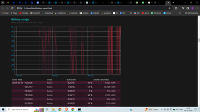

 I am facing some issues in my laptop , my laptop suddenly has issues with the battery , I have my battery fully charged to 100% within 10 minutes my battery gets reduced to 89% in another 10 minutes to 80 % then to 70% then to 60% and then suddenly to 0% and then the computer shut down and when I am pressing the power button it is not booting , but once I plugged in the cable it boot up and the battery started charging from 0 percent but suddenly after charging upto 13% it jumped to 100% what is this issue I don't understand please help in this regard.

Yes Sir I have done all the steps mentioned in the link - I have generated the battery report  -
And also performed all system test - in the battery test Initially when I did the test using Hp PC Hardware Diagnostics Windows from the computer without pressing f2 and power button the battery test result in Logic state - Weak but now again running the battery test it says OK.  I have uninstalled Microsoft ACPI Compliant Control Method Battery but still the problem is there. I am able to use Laptop with power adapter Connected. Please help in this regard
It would have been better if you had copied and pasted the results of the Battery report.
That way I can see it in its entirety instead of having to piece together parts of it from images.
From what I can see, you have allowed the battery to run down to nearly completely flat a number of times.
Doing that damages the battery and it probably why you are having problems with it.
A laptop battery of Lithium Ion type should never be allowed to drop to  lower than  20%. capacity.
Can you post the Battery report utility results in the manner that I asked so I can see all of it?
Sir the battery had run down to nearly completely flat a number of times on its own from 60% to 0 percent , I have to put the power adapter to run the laptop , I  am not able to copy paste the entire report due to word limit so I have hosted the report pdf on a site , Here is the link - Link    and Sir what may be the problem is it only of the battery or the charging circuit has failed or any software update glitch.
I would replace the battery.
