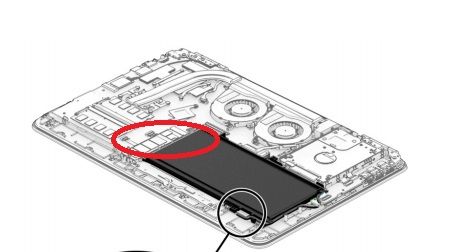

With rear cover removed this is what it looks like inside:
2 memory slots to left of red oval2 memory slots to left of red oval
