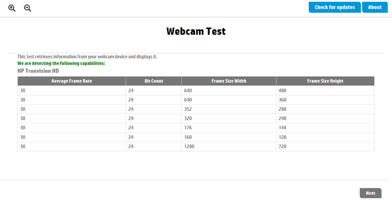

Install the Cyberlink youcam driver and check if that helps. Click here to download the same. Click here for HP PCs and Notebook - Webcam Troubleshooting (Windows 10, 8 )
Let us also run a hardware test on the webcam
- Hold the power button for at least five seconds to turn off the computer.
- Turn on the computer and immediately press Esc repeatedly, about once every second. When the menu appears, press the F2 key.
- Perform Component Test > webcam. Share the result on your next post.
Let me know how it goes.
KUMAR0307
I am an HP Employee
10-10-2020 10:41 AM - edited 10-10-2020 10:45 AM
I installed Youcam 6 still no help, I ran component test and HP Truevison HD webcam passed the test however there is one more component named cyberlink webcam splitter 6.0 which failed the test.
I tried every solution provided by HP but my webcam is not working, it is recognized by device manager but using any app only displays a black screen. But it is on as LED light is on and audio is recording. And taking a picture only freezes the app.
