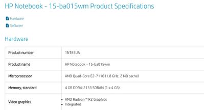

Hello, I want to upgrade the RAM memory of my notebook model: HP 15-ba015wm, in the sticker that it brings it says that it uses "DDR3L", but in the website when searching for that model it says that it uses "DDR4". I would like to know which is the correct one to be able to upgrade. thanks.

This is the website, it says "DDR4":
https://support.hp.com/us-en/document/c05620129

http://h10032.www1.hp.com/ctg/Manual/c05227786
The E2 processors are listed in several columns.  They seem to indicated that only DDR3 memory is supported.
Run the free utility that I zipped up and attached below and that will tell you what type memory is actually installed in your notebook.
